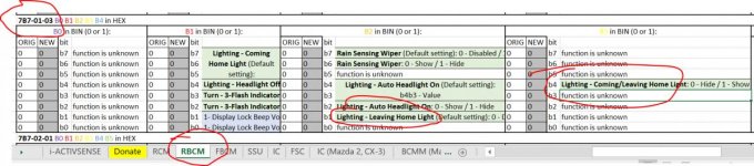

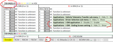

i-DM: Don`t know. Have not had a look at that ever. But I would try these settings:
Leaving home: Just search with "leaving" in this thread - there probably was a discussion about it. Perhaps it only works if you activate the lights/high beams.

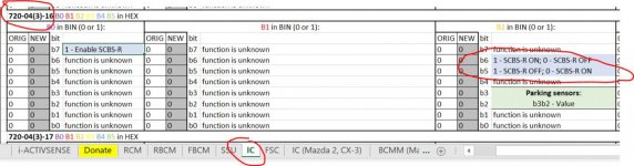

SCBS-R: I only activated it at my CX-5 2016 with MZD and I know that you have to have the car in the upper right corner when the rear camera is active - otherwise your PSM-Module is not there or not capable of SCBS-R. And in my car (not the highest equipment line) there is no own new menu item for SCBS-R in the MZD. The menu stays the same. I could only test SCBS-R to see if its activated - eg. using stapled empty cardboards/moving boxes for a test drive against them. For more info see this post.
